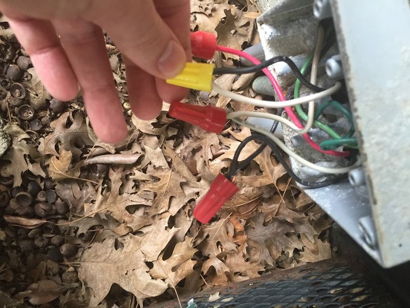

The line and load wires have been identified, the black on the left is hot, red goes to the light that doesn't work, black on right goes to the spa that does work.

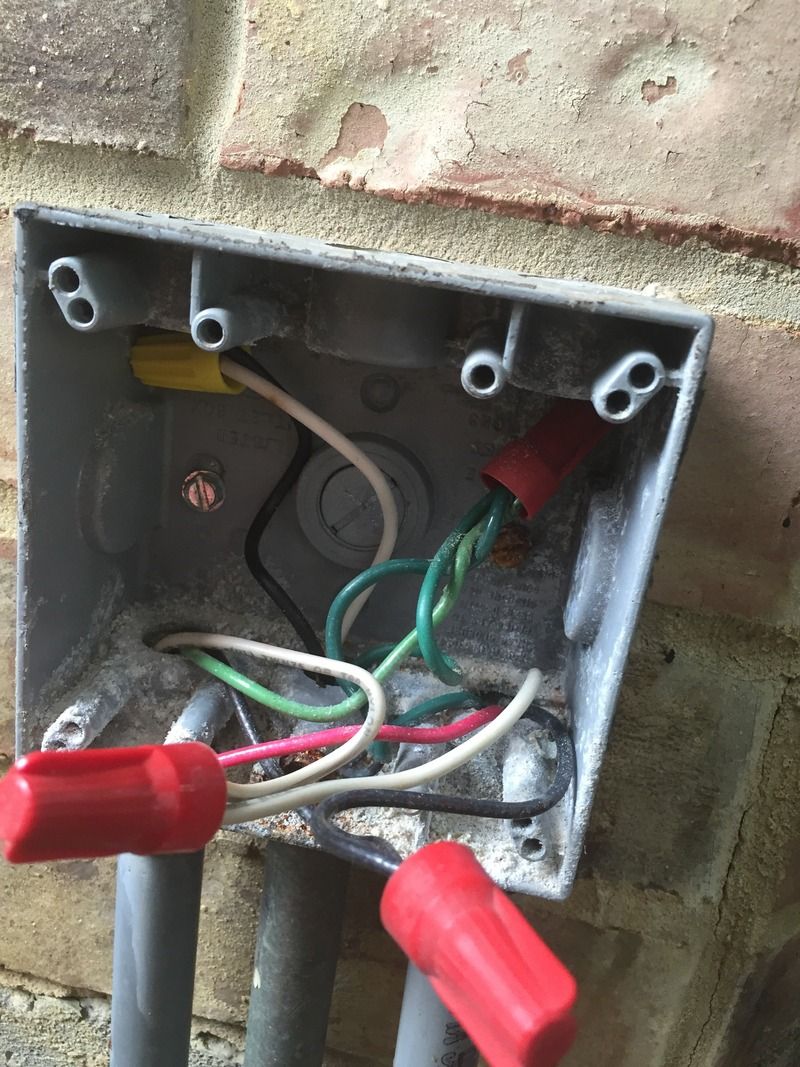

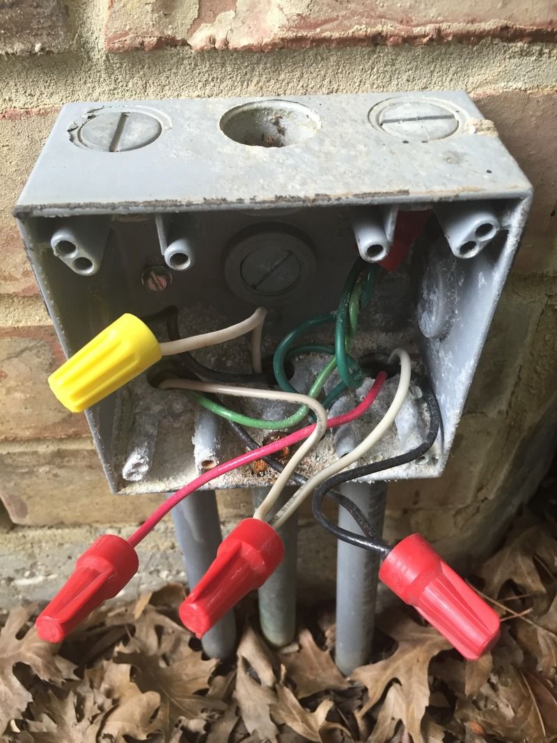

Found the box, nowhere near where I thought it would be. It was behind my pool filter. very difficult to take pics back there so bear with me.

What a cluster fuck. Your red wire being capped off is odd. It looks like it should go to the black one under the yellow nut. The white under the yellow would have to be tied into the rest of the whites.
Makes me think that it was capped for a reason.
Does the hole in the top go straight thru?
So the red that is supposed to go to the light isn't connected to anything, that is why it doesn't work.
I question the white connected to the black.
The white and black that are connected together probably go to the light and where disconnected for a reason.
When we moved in I had a pool guy look at everything and he said the light was tripping the gfi because of water in the light, he may have unhooked it as a preventative measure. The light has been dried out, replaced the bulb, and new gasket installed.
Im thinking the yellow nut is his if he did anything.. My plan was to put the red wire under the yellow cap with black but unsure what to do with the neutral.
