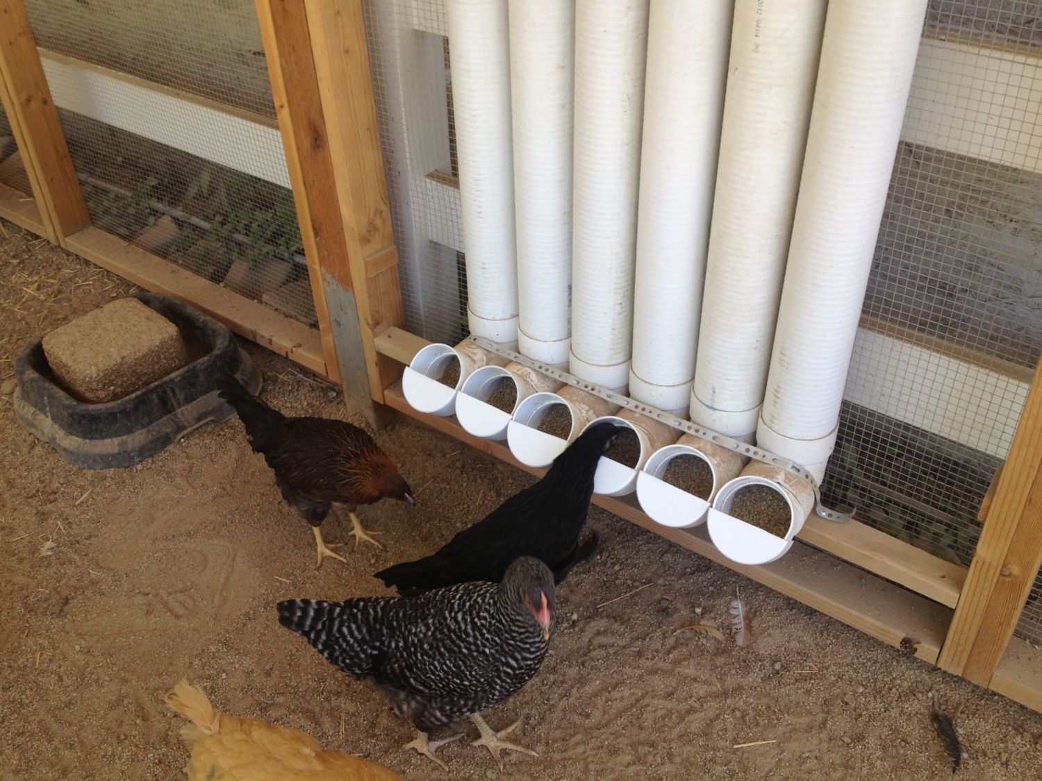

The next project is either an automatic feeder or just a big ass feeder that I only have to fill once or twice a week. I'm feeding twice a day right now. The key is to build one that reduces the amount of feed they waste. The birds like to toss the feed everywhere. I have a few designs that claim to reduce the waste a lot. I hope so.

As for a feeder, I've seen a couple cool designs made out of PVC that are basically the same idea as your watering system.
Here are the designs I've been looking to recreate when I get back into this. Most of these are all so simple I feel dumb for not thinking of them myself. Looks like something like these might work for you since you have extra room up above the cage.

I've see most of those pics of feeders myself. I may try something just like one of those.
