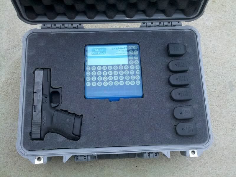

    There you go, talking about me again.
    I built a hot wire knife using some ni-chrome wire, a transformer, brass rod, dimmer switch,and other miscellaneous crap from the hardware store. Worked well, just have to run slow and low temp to get it right.
    That's pretty much what I'd like to do. I like the clean cut lines. I'll probably end up buying a second foam liner for cutting patterns for different guns, too. Where did you get those parts from?

    Quote Originally Posted by KS63 View Post
    The transformer came from radio shack, ni-chrome from ebay, the rest from ace/home depot/lowes/whatever.
    I bought 1" foam, 4 pieces, so i could set different levels for everything. The glock is in one layer, the ammo is in 3 and the mags are in 3. I spray glued everything together when i was done cutting.
