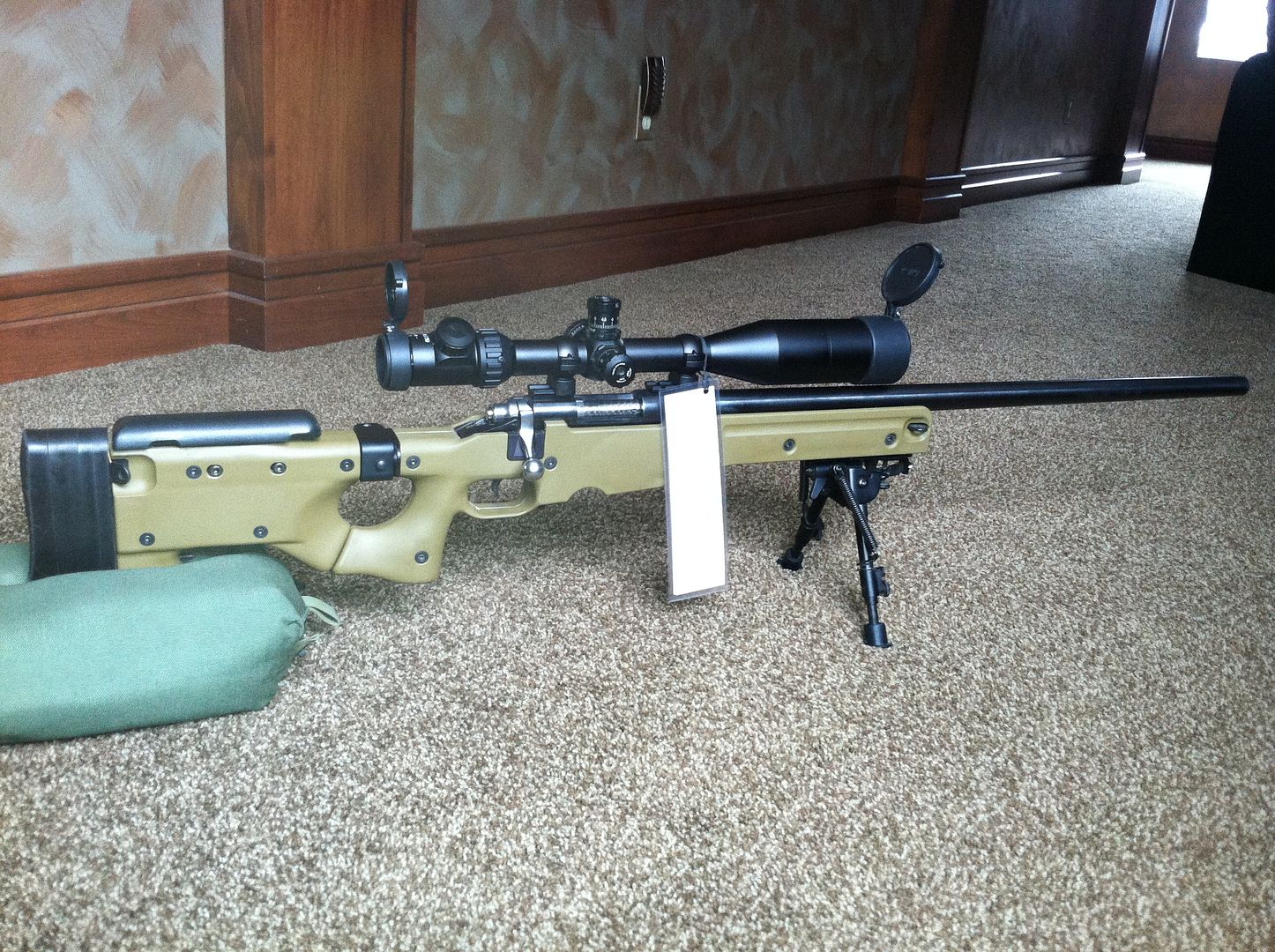

    Here it is in the AICS is now shares with my .260.

    Those are nice rifles, i about when you mentioned cutting the bbl. recrown, shoot and enjoy.

    Damn purty.. Every time you talk about doing .22 it makes me want to do it..
