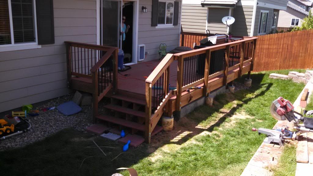

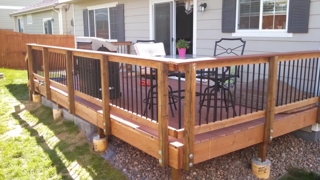

    She is done. Pics don't show the last couple metal rails I added at the corner but that is pretty much what it looks like finished. right now I like the look without the lattice but might add it later. We don't get any trash and tumble weeds in the back so I don't think it will be an issue collecting crap under it.
  6. #56
    That's a pretty elaborate step for your dog to use the doggy door. Looks well done.
    Anything for those dogs!
