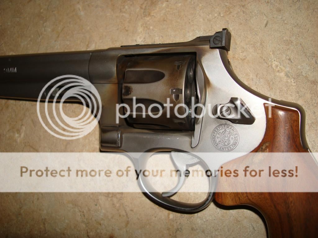

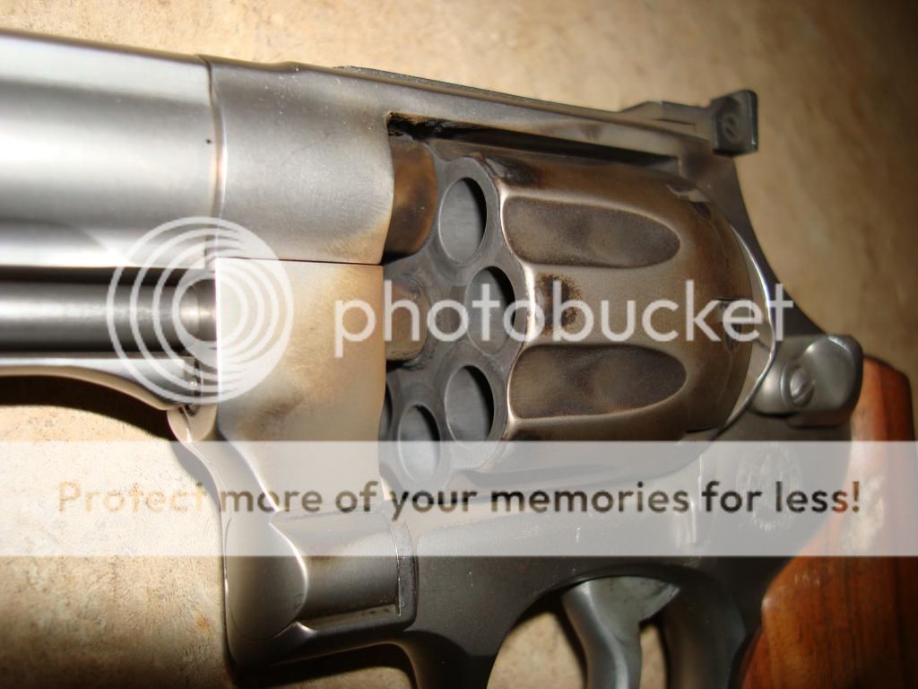

    One month and about 2,000-3,000 rounds later.
    Very happy.

    I noticed that you took off the compensator. Was it friction-fitted & pinned or welded on?

    It is a slip on and then held in place with a screw. It was a pretty worthless single chamber comp. The non compensated endcap was useless as well.

    Looks fun. How is it you ain't got no glory hole in the side? How do you fire that single action?

    I pulled the 9mm barrel, crane and cylinder off the 929 frame and stuck them in a 627 (38 Special) frame. As soon as I get the trigger job done on the 627 (the frame says 929) it will be on the chopping block. I have no desire to own a lock gun.
    Single action? Why the hell would I do that when double action is easier? In fact, I cut the SA notch off the hammer so it isnt even a option in any way, shape or form. Shooting a Double Action revo Single Action is for people who squat to pee.
