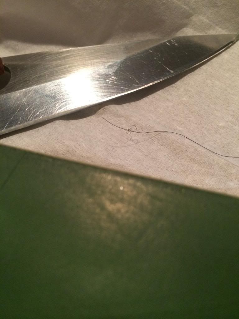

    Lately I've been practicing on stropping my knives. Today I showed a coworker how sharp I was able to sharpen my EDC endura. The knife has been through hell and back, no point, carried daily for 5+ years. I cut some thin paper receipts and shaved the little hair I have on my arms. When I got home I stropped it again and stole a piece if hair from the wife's head. It was sharp enough to whittle hair!
