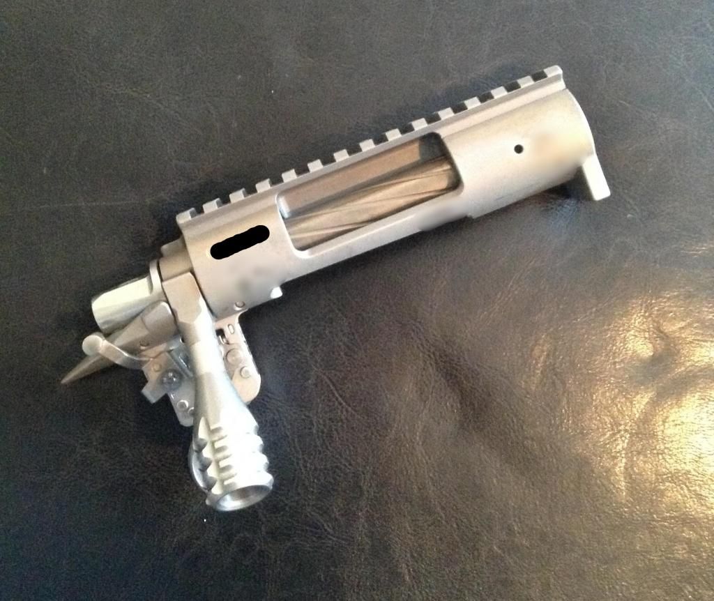

    So Ray is getting some pretty good input on his thread, so I'm gonna give this a shot on my own thread. So I have an action laying around with no dedicated purpose, it's a Surgeon Short Action 591 repeater with a .308 bolt face. I want to build a dedicated truck gun, short barrel 18" at most. Primary use will be 800yds and in, critter getter and possibly deer. I know my options on .308 already and it may be the way it goes, but looking for some other input on different calibers, folding stocks, etc. Not in a rush to build it, but I'm ready to gather the rest of the parts. So fire away guys, opinions, photo examples of shit you like, weight will be a concern but not a set point. Here is a pic of the action to be used..............
