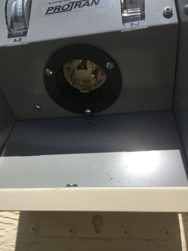

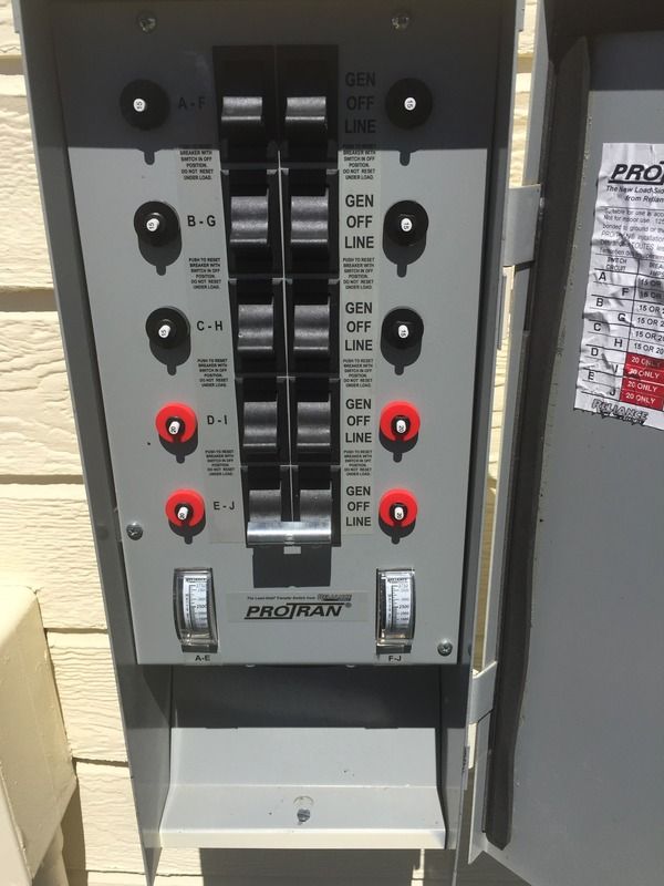

    Recently moved to a house that is wired for generator backup. On the outside is this setup
    On the bottom is this plug, I believe it is a L14-30 style plug.
    My generator is a Duramax EP4850-EX, and the plug matches
    Is it as simple as getting a extension that matches? Do i need a special gauge per length?

    You need to verify guage based on amps and length. Google has plenty of charts.
    Amps also need to be verified for the panel draw and the plug rating.
    Gong Shooter PSS's Avatar
    Delta
    438
    Short answer is you need #10 gauge 4 wire SO cord. Limit the length of cord. I'd keep it within 20 ft personally.

    Turn off all circuits on the generator, start generator, then slowly turn each circuit on. Unless you have an auto-start generator back up. In that case get a bigger generator.

    1. It would behoove you to figure out what each circuit feeds before you need to hook up the generator. You might turn a particular circuit off-on-off, as needed and when needed.
    turn on the ones you need. Run the furnace at night, fridge during day etc. Alternate. I can run one or two of these devices together usually with my 1850 watt.
    Be sure one breaker has some lights, another furnace, another fridge/kitchen. I don't need to run it all at once.
