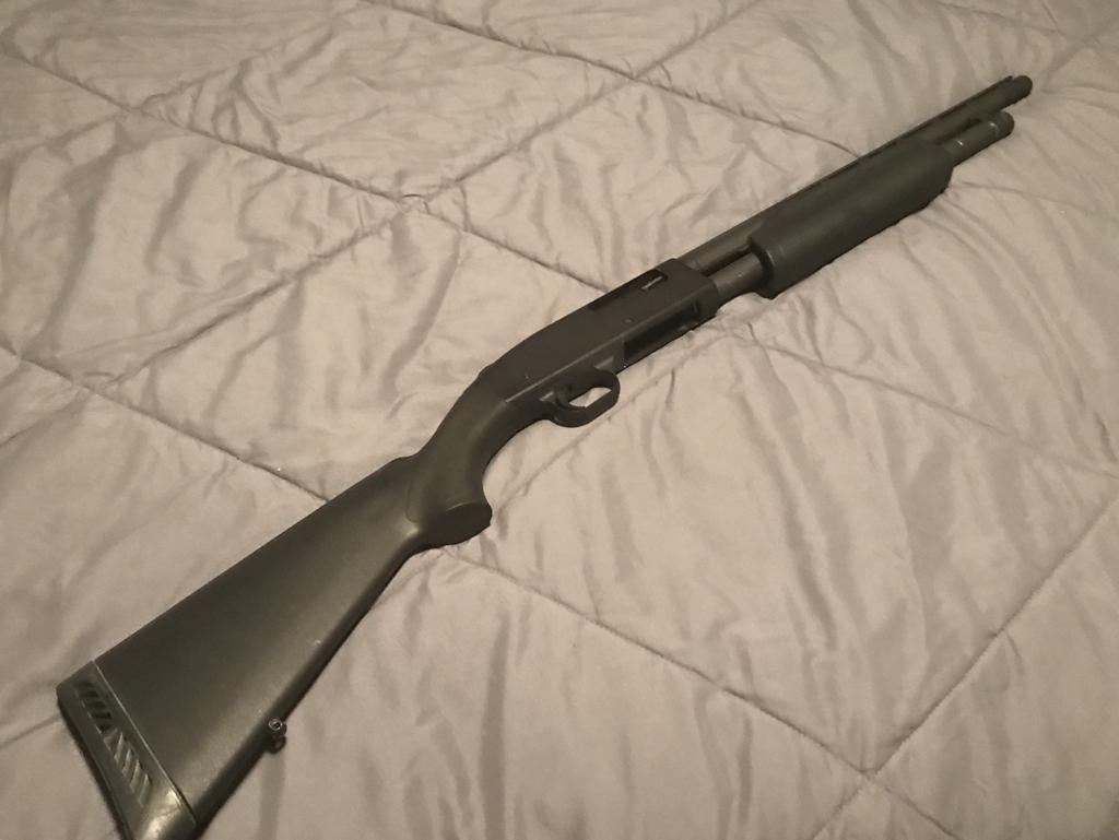

    Any tips for doing a rattle can paint job? I?ve never done it before and I have an old 20g mossy sitting in the safe that could use a Maaco paint job. It?s got lots of scratches and scrapes and I?m thinking a two tone paint job would look pretty good on it.

    Degrease it really good. That?s my main tip.

    I used VHT high temp engine. I wanted a chance of solvent resistance. Was very easy to scratch after 24 hours. Looked online folks said wait a week or two. After doing that (waiting 2 weeks)it has been surprisingly durable. Problem is you have to pick an engine color. Purchased at Advanced Auto.

    Appliance Epoxy paint.

    Brownells Alumahyde (not to be confused with formaldehyde) . You can either bake the parts in an over. OR if patient enough let it cure (air dry) for 2 weeks. The Epoxy paints are not bad either. What ever you choose will need drying time.
    +1 to this. The prep work should not be rushed. Poor prep = poor job whatever you use.
    3,103
    We have some wax and grease remover that the guys on the paint crew use to clean their guns. Now that I am thinking about it, I may even be able to get them to sandblast it first..
    I typically leave the original finish underneath the paint job. As the paint gets scratched or worn or whatever I would rather expose ratty old finish than bare metal. I'm sure glass beading or sand blasting would promote good adhesion for the new finish though.
