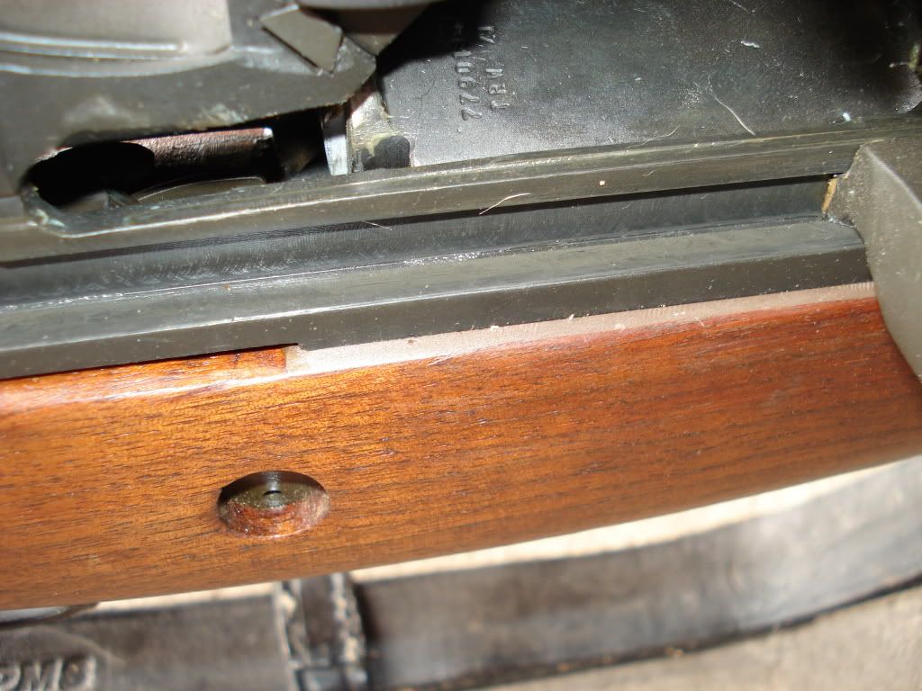

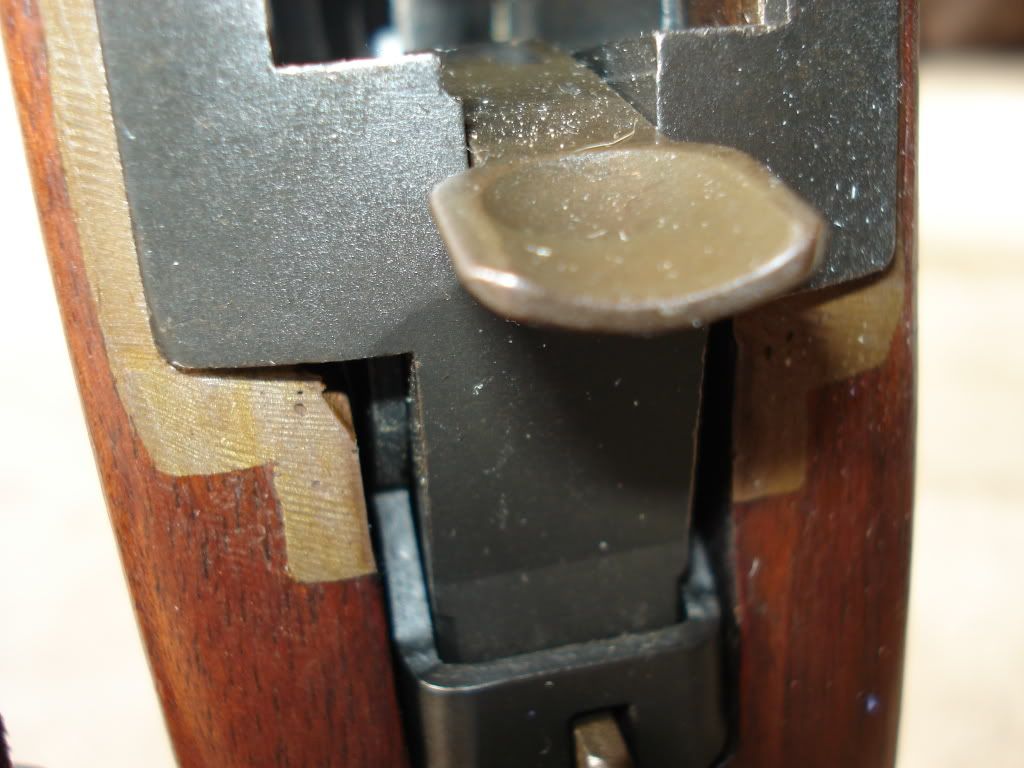

    When I built mine about 12 years ago a retired Navy armorer in Virginia Beach did all the fitting, assembly and glass work and I did most of the parts search (they only thing we kept from the original rifle I acquired was the receiver). I found some parts on Ebay (don't think you can get them their anymore?), some on Gunbroker, but most parts came from Numrich and Fulton, with the barrel from Krieger.
    By the time I got the thing put together and back I could have bought 2 ultra match rifles from SA...

    A little Glass
    100 yrd groups:
