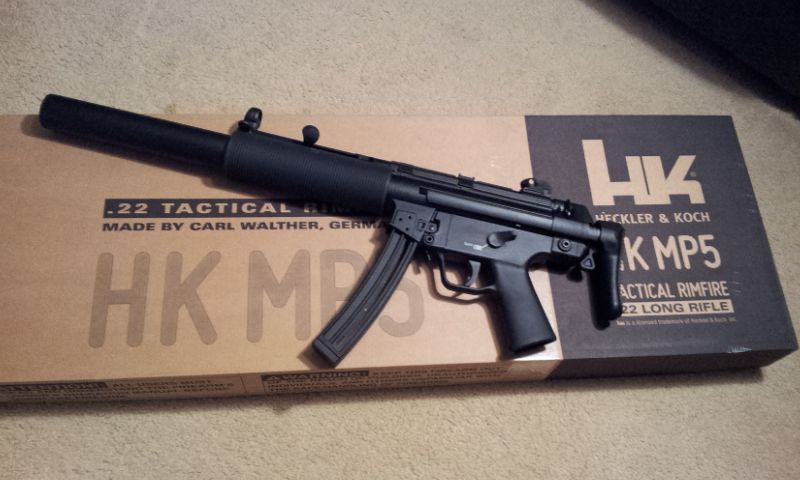

    AztecWarrior
    I've had one for about a month now and have about 700 rounds through it. I agree with most people who own them, the collapsable stock sucks and I don't really like the paint on it it seems really thin and easy to scratch but overall the rest of the gun is alot of fun. Everything is really well built. I got mine at Gander mountain for $500 but I should have check sportsmans because they have them for $450. Here's a pic of mine...
