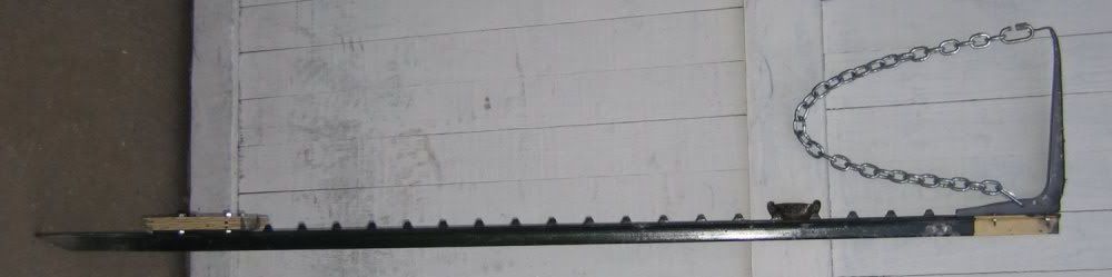

    I built a steel hanging target from a piece of Dodge pickup truck spring.

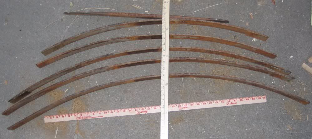

    The spring material is 2 1/2" wide and mostly 0.28" thick except where it tapers down on one end.
    The bottom leaf in the spring set is thicker - .5" but it tapers sharply at both ends.
    This stuff dulled a high quality sawzall blade almost immediately and only showed a small scratch.
    I had to cut it with an angle grinder.
    I haven't tried drilling it yet.
    I built a hanger from a steel fence post, a shelf bracket and some chain.

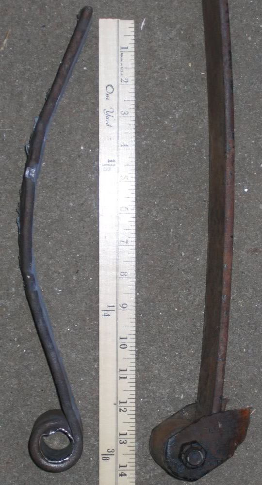

    After one day of shooting mostly with M193, and a few rounds of AK and a few 9mm:
    It has been significantly bent back against its original curve to the point where I think breaking in half is likely.
    It has quite a few nasty dents and 11 holes or chunks shot out.
    The shelf bracket is getting some splatter damage too.

    Here's a piece of truck leaf spring that we used closer in for 9mm and .40 S&W.
    It's not even dimpling!

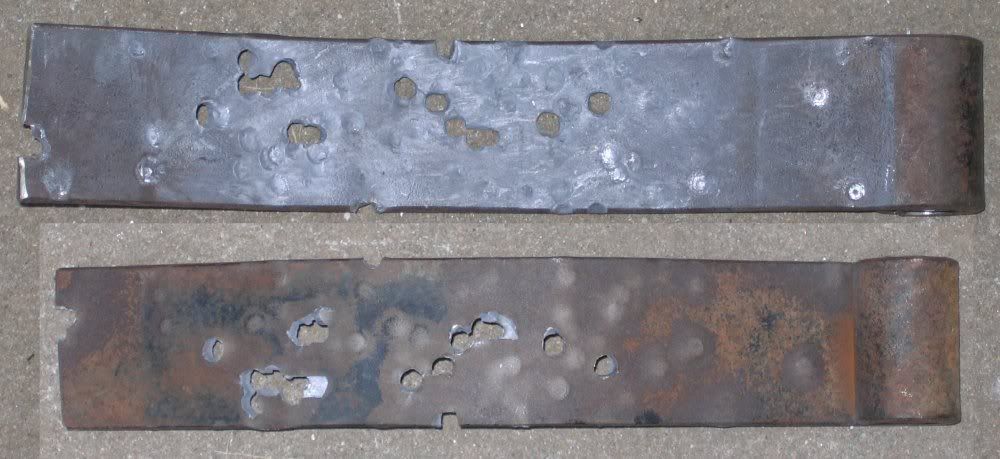

    After today, the August 12 shoot & one previous day, my railroad tie plate steel target is showing some serious wear.
    It's got 4 or so holes shot through it now. It's probably only good for one more shooting day.

    It is alot of fun! It makes a whack sound rather than a ring when you hit.
    The majority of hits have been cheap 223 ball ammo at 70 yards give or take.
    It has received a sampling of other calibers, 308, 9, 454.
    The front view doesn't really show how tortured that metal is.
    most of those dents have sharp raised edges - it would hurt to touch it the wrong way.
