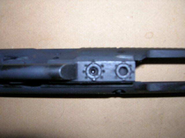

    Jim...exactly my point
    I don't like messing with dinky pins at an outdoor (or most indoor) range
    and little springs...no thanks...I am way too clumsy
    A properly staked carrier key

    Quote Originally Posted by Obiwan
    Thank you! Never could get anyone to say what exactly the hell that meant.

    There are a lot of carriers out there that are very poorly staked..if at all
    I saw a post where a PD recently got a dozen Bushmasters and none were properly staked...one was actually loose
    Other than bad ammo carrier keys and bolt breakage are two of the biggest reasons for an AR to go down hard
    This guy sells a really good staking tool...a little pricey

    This is my M16 carrier that came loose not long after I got it........it's a bushmaster and this is what I did and have never had a problem since. I did not buy any high dollar tools I simply used a center punch and a hammer. 10K rounds later it still has not come loose.
    [wink]
    Sorry for the crappy pic.
