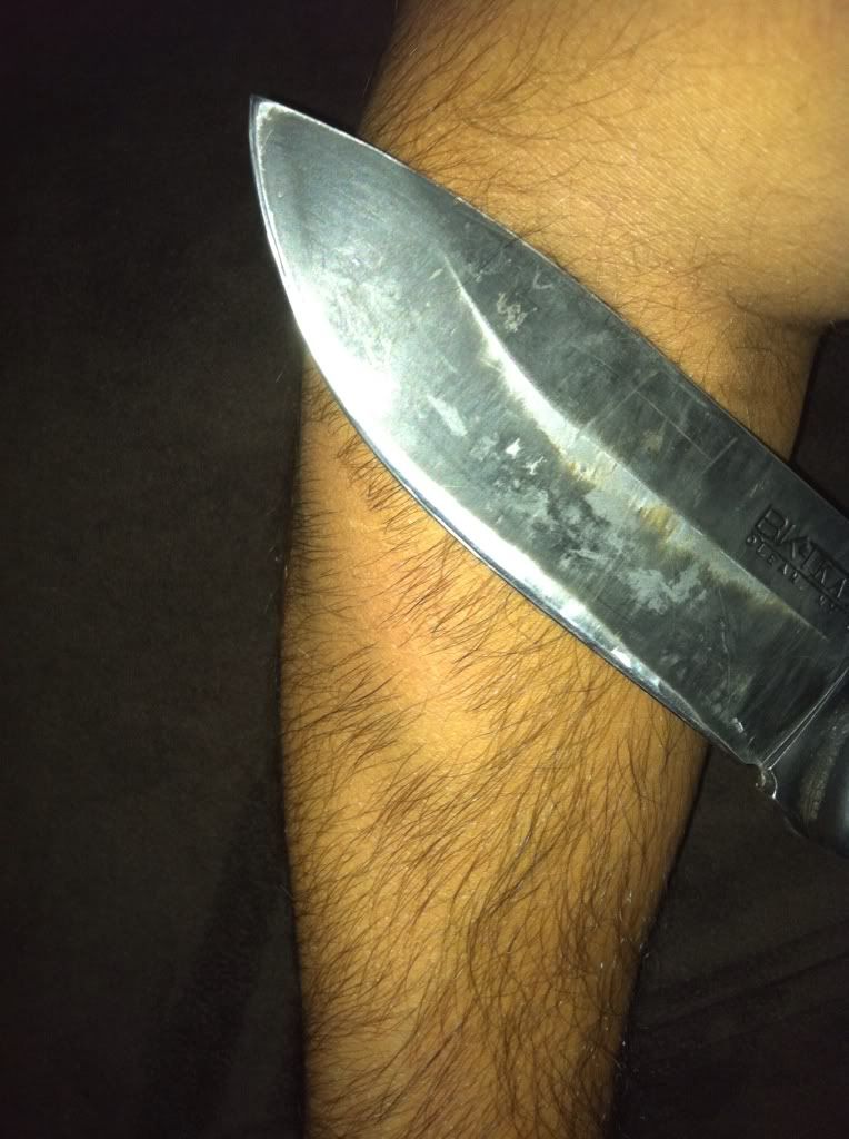

    Got a convexed edge on my BK2 via stropping on 1k grit and then 2k grit.
    The sandpaper was paper clipped onto a mousepad which was glued onto a thick paint stir stick (the stir stick acting as a handle and rigid support
    Afterward did about 100 laps on a leather belt and then ran it across my arm hair...
    it clean shaved it.
    I will be using this sharpening method from now on and i thought the knowledge should be shared.
    fyi- this blade is not designed to be honed this sharp- but it is VERY easily doable.

    the method is this:
    glue a mousepad strip to some hard flat surface with a handle (paint stir stick for me) and paperclip a piece of sandpaper to the stick.
    -for nicked edges or blunted blades start at 600grit or coarser
    -for an edge that will catch and shave the the top of your thumbnail start with 1k grit
    Use the paddle as a strop- meaning you have the blade facing you as you push it away from you. the blade is away from you as you draw it towards yourself. DO NOT ROLL THE BLADE AS YOU CHANGE DIRECTIONS- come all the way off the surface and then flip it
    Use an 'x' motion when doing this so that you draw away from yourself left to right and draw towards yourself right to left.
    The blade should be at appx. 30 degrees from the sand paper
    When starting -pressure on the blade is enough to feel the mousepad give. do 20-40 laps at this pressure.
    Taper the pressure off on each grit before going to the next highest grit. the last laps should be just the weight of the blade and no more pressure.
    1k grit gets scary sharp
    2k grit gets arm hair snag sharp
    leather belt stropping after 2k gets arm hair shave.
    (this is the method i used to restore my grandfathers straight razor, with the exception that i took the straight razor all the way to an 8k honing stone before leather stropping)
