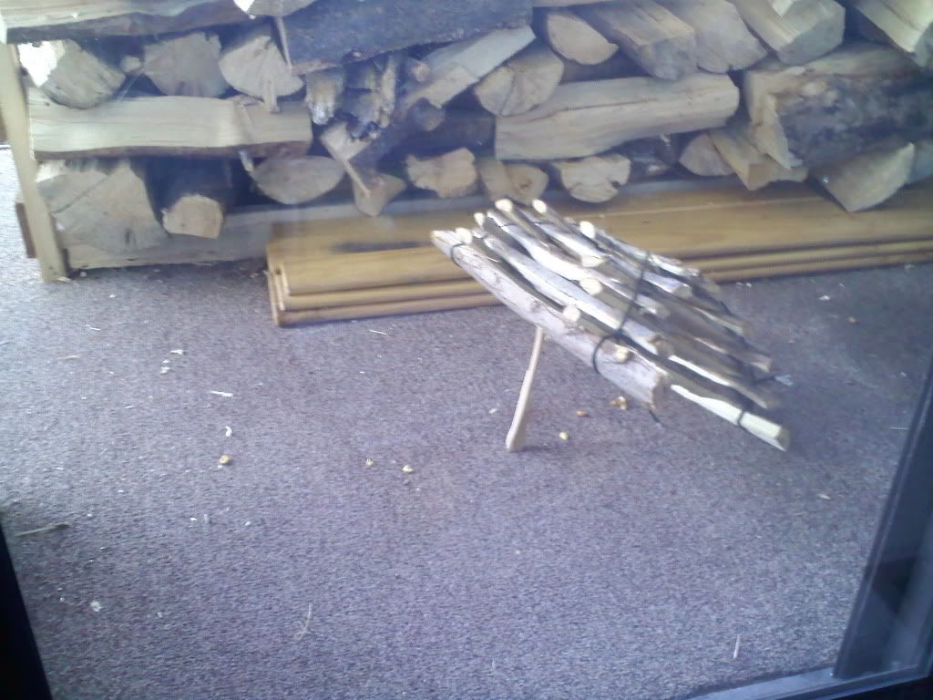

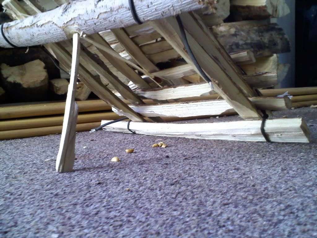

I also took a few pictures of the trap, the bait, an example of how to set the trap, and it all set up waiting to catch a squirrel.

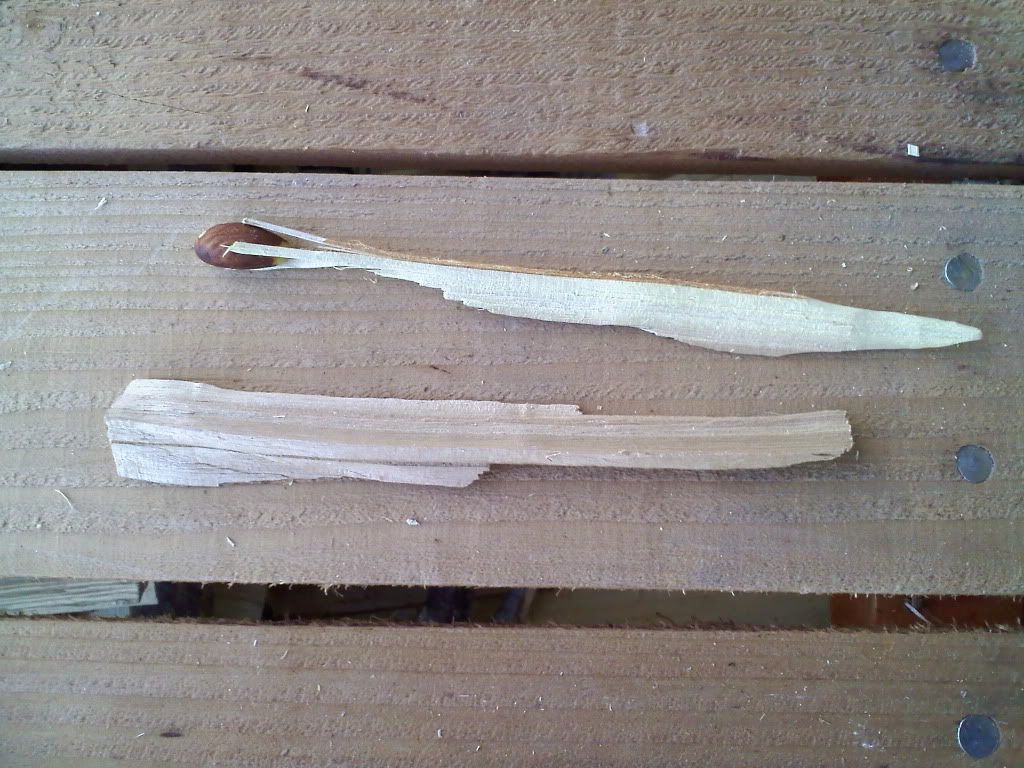

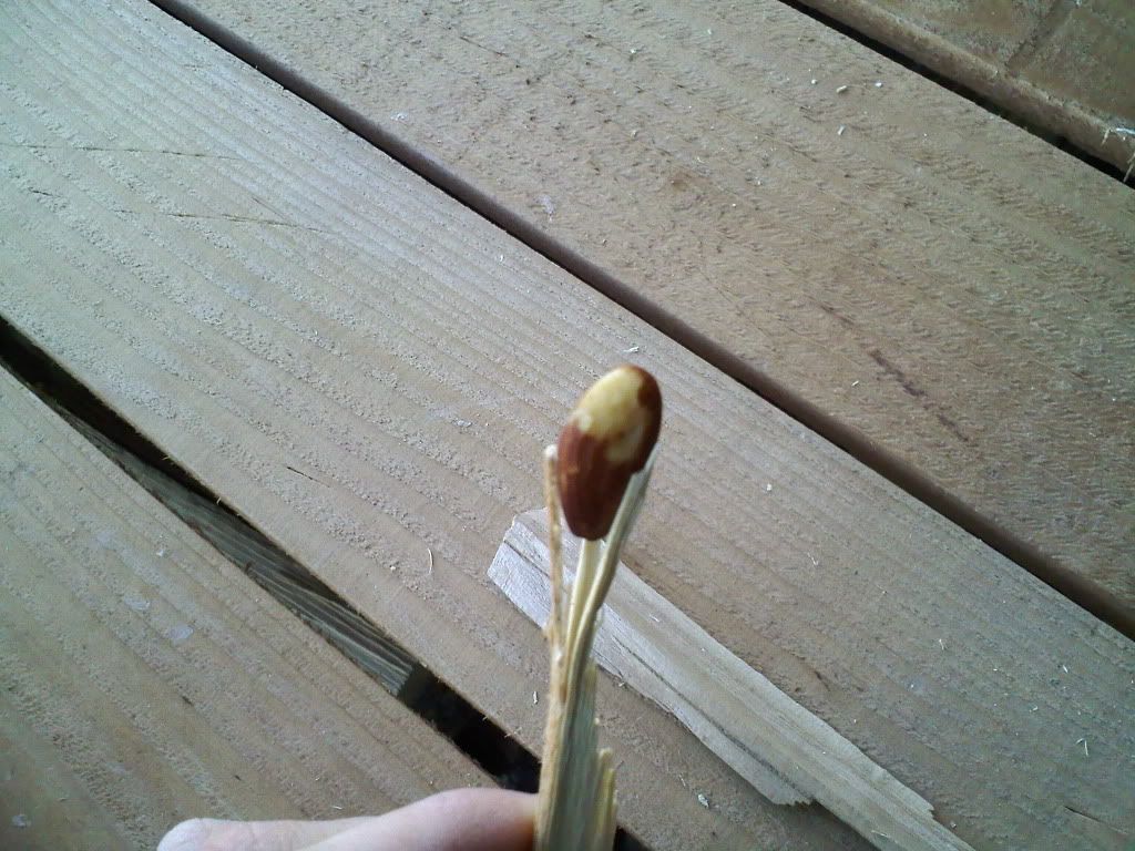

Here are the two sticks I used to hold the bait. I tried to really wedge that nut in there, because I'm not very good at setting the trap to be as sensitive as I'd like.
You basically set up the two sticks like this. Then you set the trap on the top of the horizontal stick. If you set it up right, it should only take a small movement to spring the trap.
