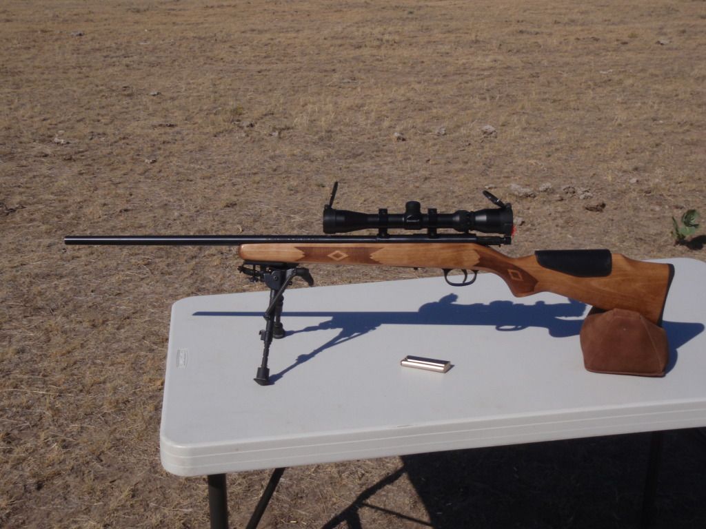

    After finding a renewed interest in my Marlin 25N I decided the barrel "needed" to be floated for better accuracy. I promptly removed the stock and started sanding away. After about 20 minutes I was proud of my work and put the rifle back together...
    Not enough planning showed itself when my assembled rifle acted like a see-saw. That is when I started trolling Rimfire Central for a fix or replacement stock options. I saw a thread with pics of a bedded 25 and decided I would try that before buying a Boyd's or Marlin stock.
    I decided to pillar bed the receiver with brass pipe fittings and a Miles Gilbert Bedrock glass bedding kit for about $25. I also planned on refinishing the stock so I wasn't too worried about the existing finish while bedding. The finish is Minwax Special Walnut 224 stain and 4 or 5 light coats of Tru-Oil. The shine was knocked down with some steel wool.
    Also some non stock related upgrades I did were polishing the trigger and experimenting with some springs to get it where I like it. I removed the front sight post and fashioned a plug out of the stock screw so the hole is filled. The cheek rest is made out of some 1/4" ABS plastic molded with a heat gun and sanded to shape.
    Here's my starting point.
    Bedding job from the top and bottom.
    Stripped and sanded stock. Reassembled to decide if I wanted it blonde or to stain it darker.
    After 1 light coat of walnut stain.
    Finished rifle on the bench (as a comparison to the starting pic)
    And a picture of it in the sun after a day at the range.

    Turned out nice.
    Nice job, good work there

    I'll take it! Looks great, thanks for sharing.

    Very nice spongejosh. Did it improve the accuracy?
    600
    Looks great! My father in law gave me one of these. Accurate already but did it get any better?
