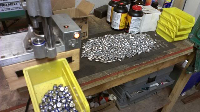

  7. #707
    48,103
    loaded 20 rds of 223 sub -sonic, with tighter crimp. road test this weekend
    road tested some SMK 55 gr JSP, Hornady 55gr SPSE. Very happy with those loads.
    assisted another shooter on the 550 for some 158 gr LSWC in 38 spl
