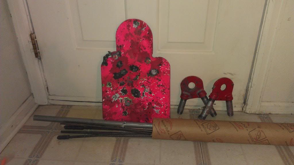

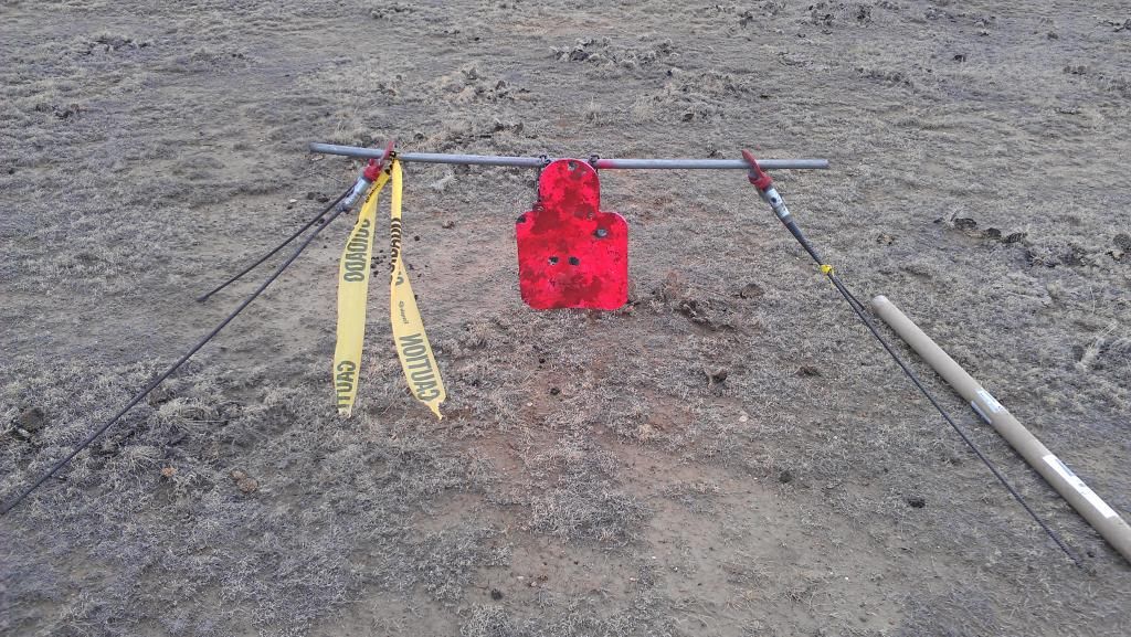

    Here are my steel target set ups.
    Broken down. Steel is 18" in height by 12" wide. it's so light that I use this target for a thousand and out. It dances when you hit
    All set up:

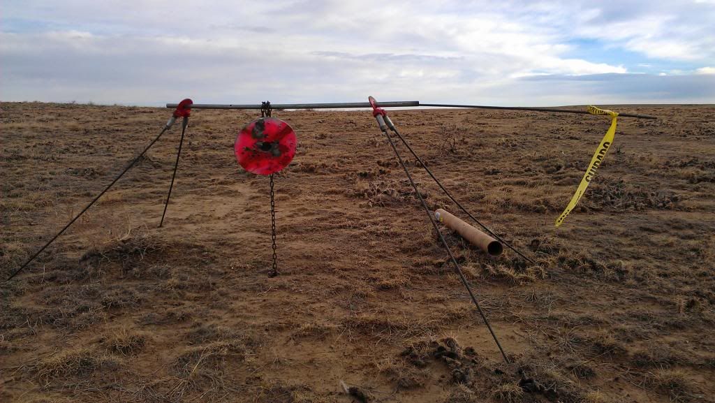

    Here's one that I use for 200 yards to 600 yards.
    It's a brake rotor with another piece of steel in the back (It's now up front). I went this route so I don't have to worry about ruining it with armor piercing, or steel core rounds shooting it.
    I also painted the steel reddish/pinkish high florescent color so I could find them at far distances not much for spotting hits... the back is black so when it gets hit it starts flopping around giving a good indication it was a hit...
    I learned all that stuff from you guys on here!

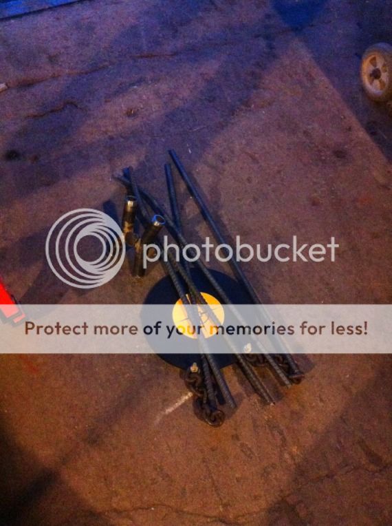

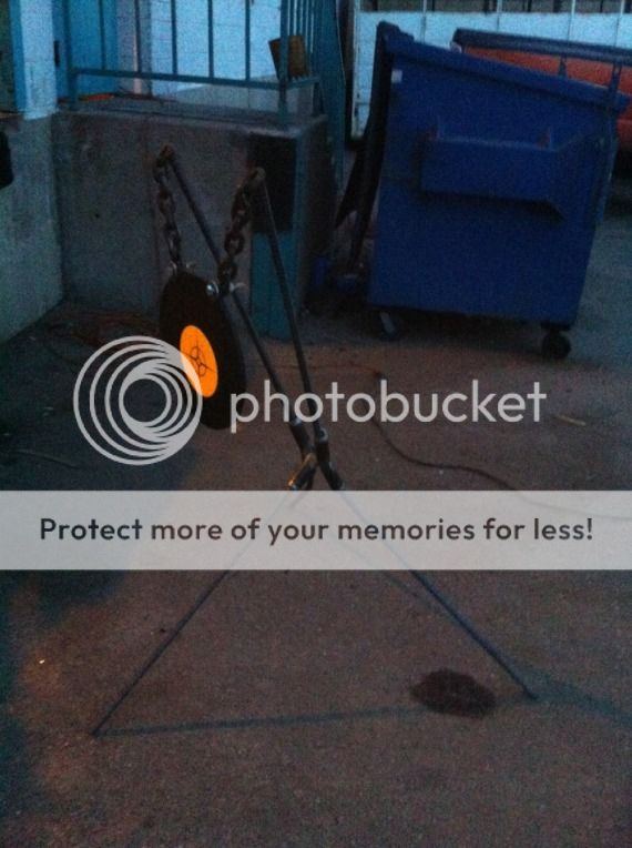

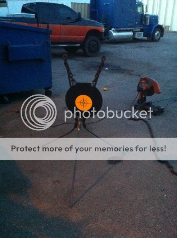

    ok here is the first prototype I made it out of some junk laying around the shop in about a hour. Im gona make a new on when I get the steel for the torso

    Quote Originally Posted by soldier-of-the-apocalypse View Post
    You realize the first time you miss low you can completely destroy the stand?
    I doubt it the steel I used was 1/4 inch thick so it should hold up to .308 but like I said the original plan was to put another peice of ar500 below

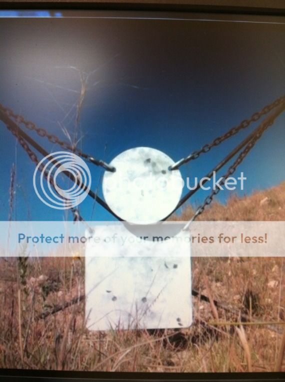

    here is a pic of the magpul target I should have watched the video again before I made mine lol
    308 will smoke through .250 mild steel like it wasnt even there, even past 600 yards.
    If you put a chunk of AR-500 in front of the base it should help. Keep in mind how low the bottom target is. If you miss low, you can throw a bunch of dirt on the plate and they get really hard to see with a fresh coat of dirt.
